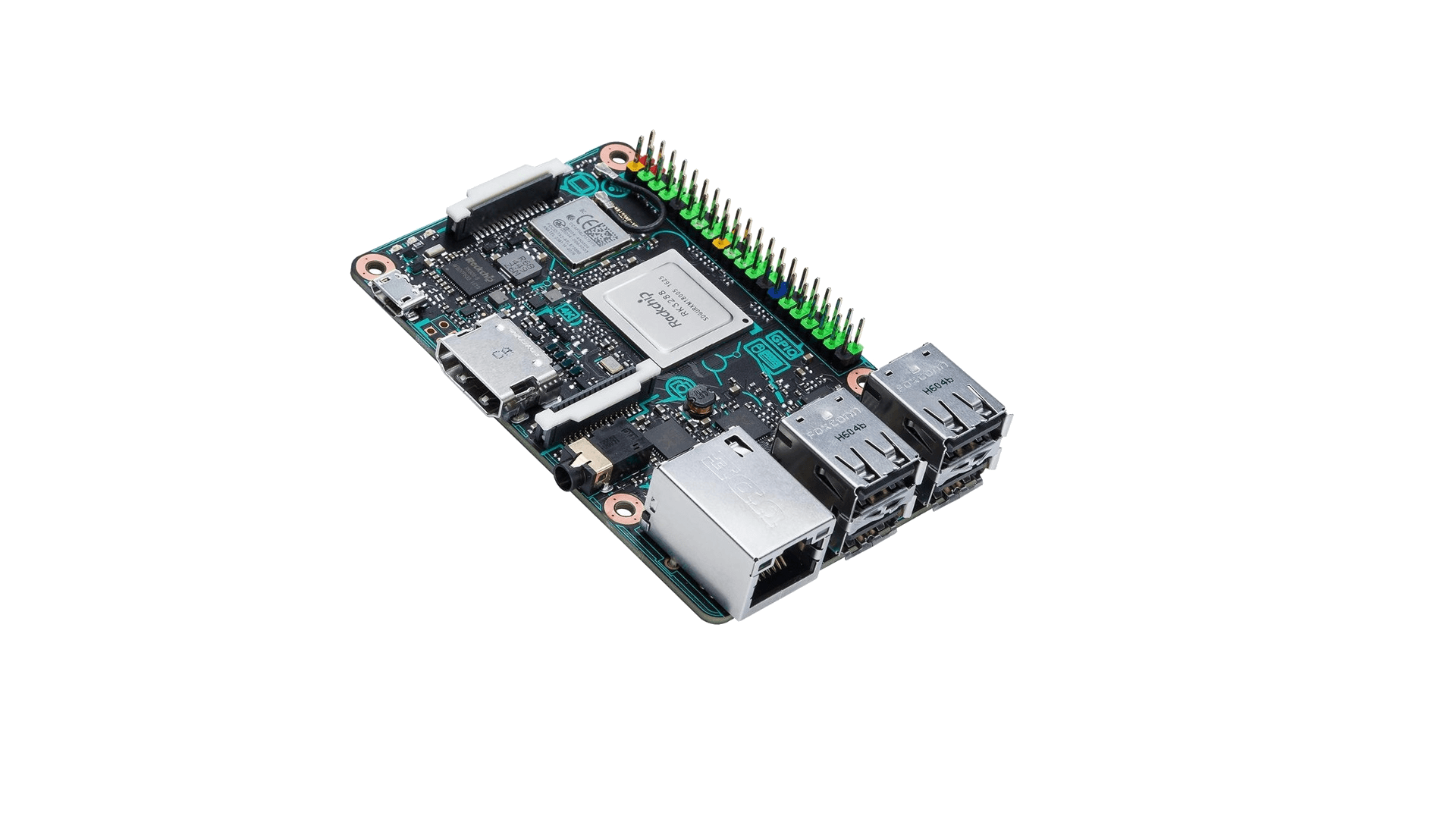

Severe powering troubles due to Micro USB power connector. It’s recommended to power through GPIO pins to prevent under-voltage issues (instabilities, boot/crash cycles). Powering situation is a little improved/masked on model S. serial console is enabled on UART2 (pin 32, 33, 34=gnd) eMMC flashing (model Tinkerboard S with eMMC) can be done the same way as burning an SD …
it’s highly recommended to power via header with quality and powerful (3A) PSU – if you want stable operations and overclocking? In another word – don’t even try to power via stock micro USB power connector since your board will suffer from regular crashing and might not even boot up. booting from eMMC is currently broken. In case …
