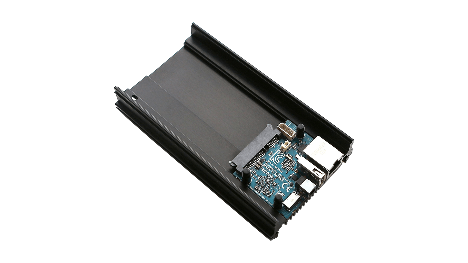

This board is stripped Odroid XU4 and we use the same images, however, we provide a specially optimized config (for kernel 4.14.y or higher) which has to be applied manually. This results in shorter boot time and lower consumption. Run armbian-config utility and go to section system -> DTB and select optimized board configuration for Odroid HC1. …
