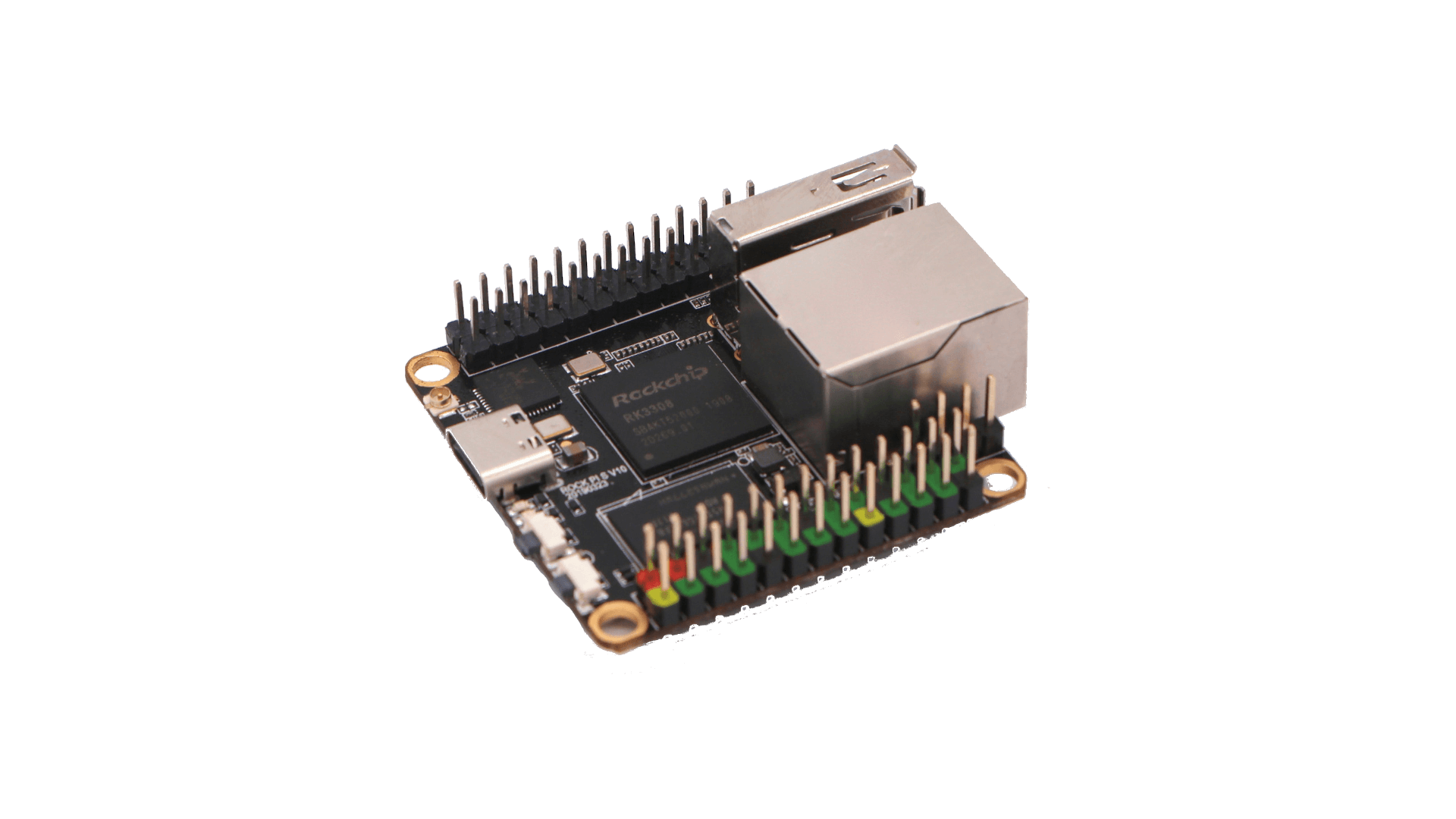

- If your RockPi-S is equipped a large enough SDNAND, you may flash an OS image directly to this internal flash as follows:
- Build Linux x86 binary rkdeveloptool (sources) on host
- Remove any SDcard
- Plug the USB-C port into your computer
- Hold down MASKROM button while you…
- Power on or press the RESET button to enter flash mode
- Release the MASKROM button after 2 seconds
