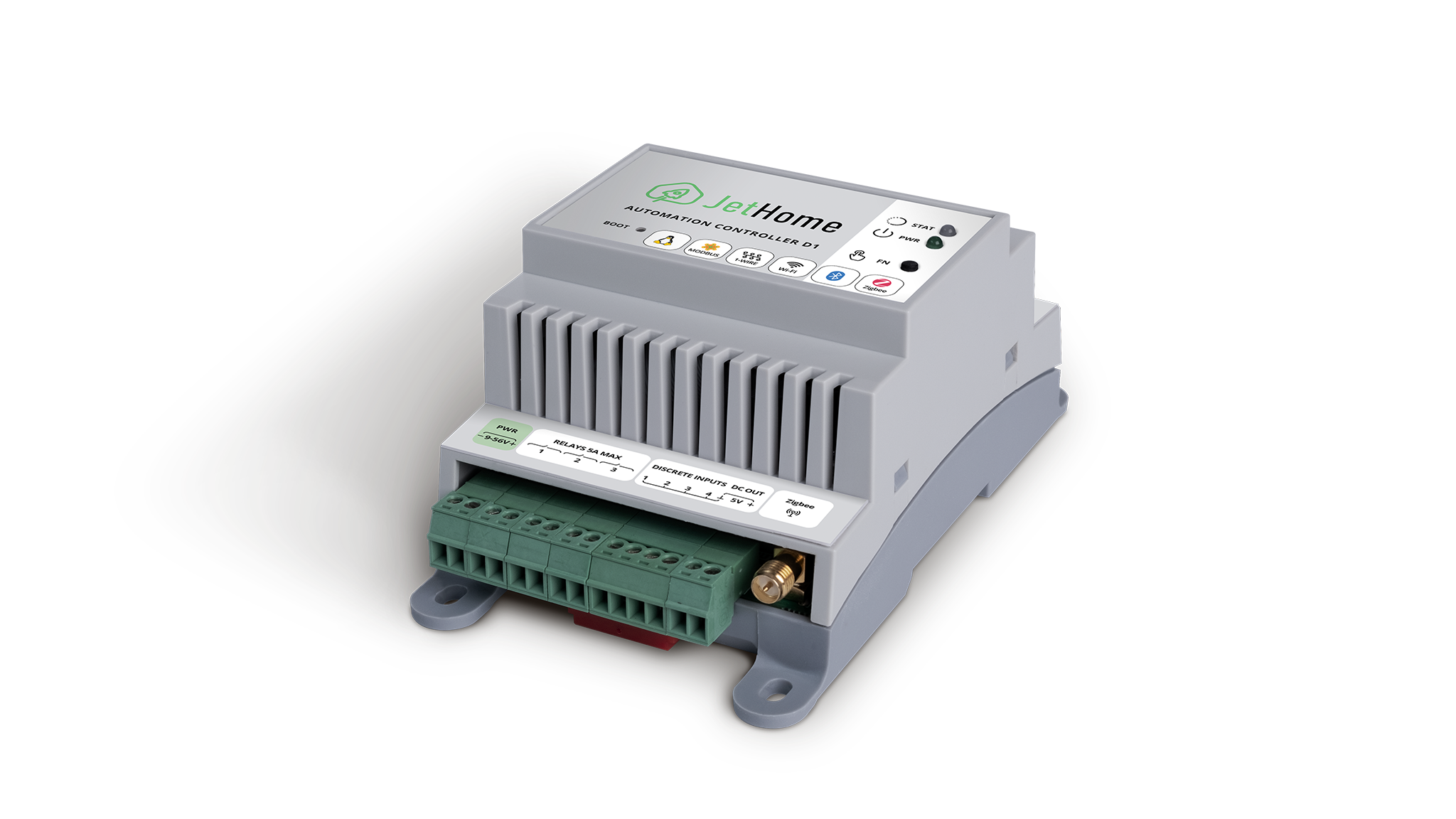

In order to boot Armbian from JetHub D1 with pre-flashed OS on eMMC you need USB-USB cable and do: Download Amlogic Burning Tool Download latest burnable firmware (testing branch) Flash! More instructions on https://wiki.jethome.ru/en/jethub_d1#controller_firmware Now you can boot Armbian from eMMC.

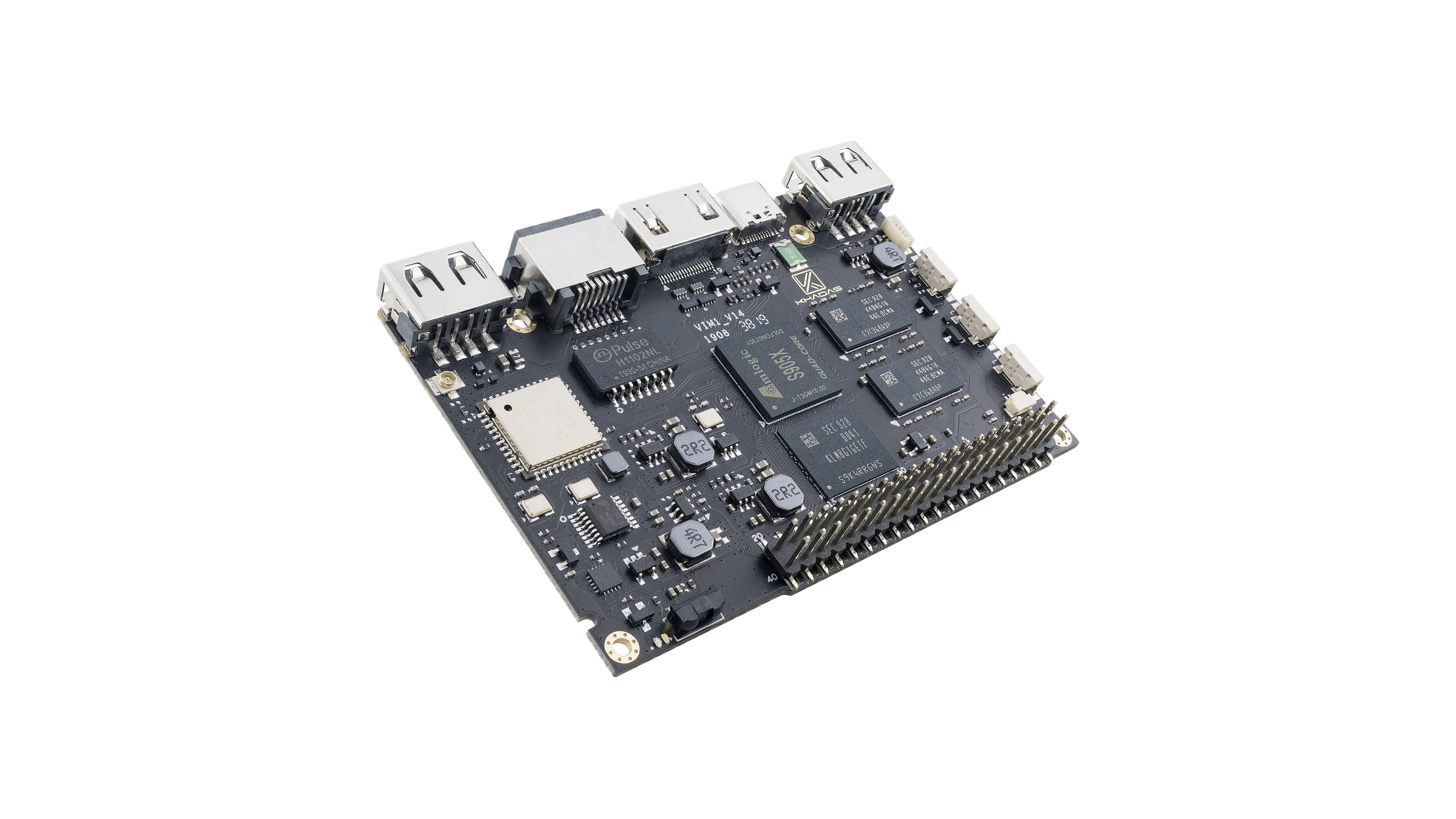

In order to boot Armbian from VIM3 with pre-flashed OS on eMMC you need to: Download Khadas Rescue tool for VIM3 and flash it to a spare SD card Insert SD card, attach USB keyboard + monitor or a serial console and boot into Khadas Rescue Tool Choose: Advanced -> eMMC -> Fast erase. Go …
